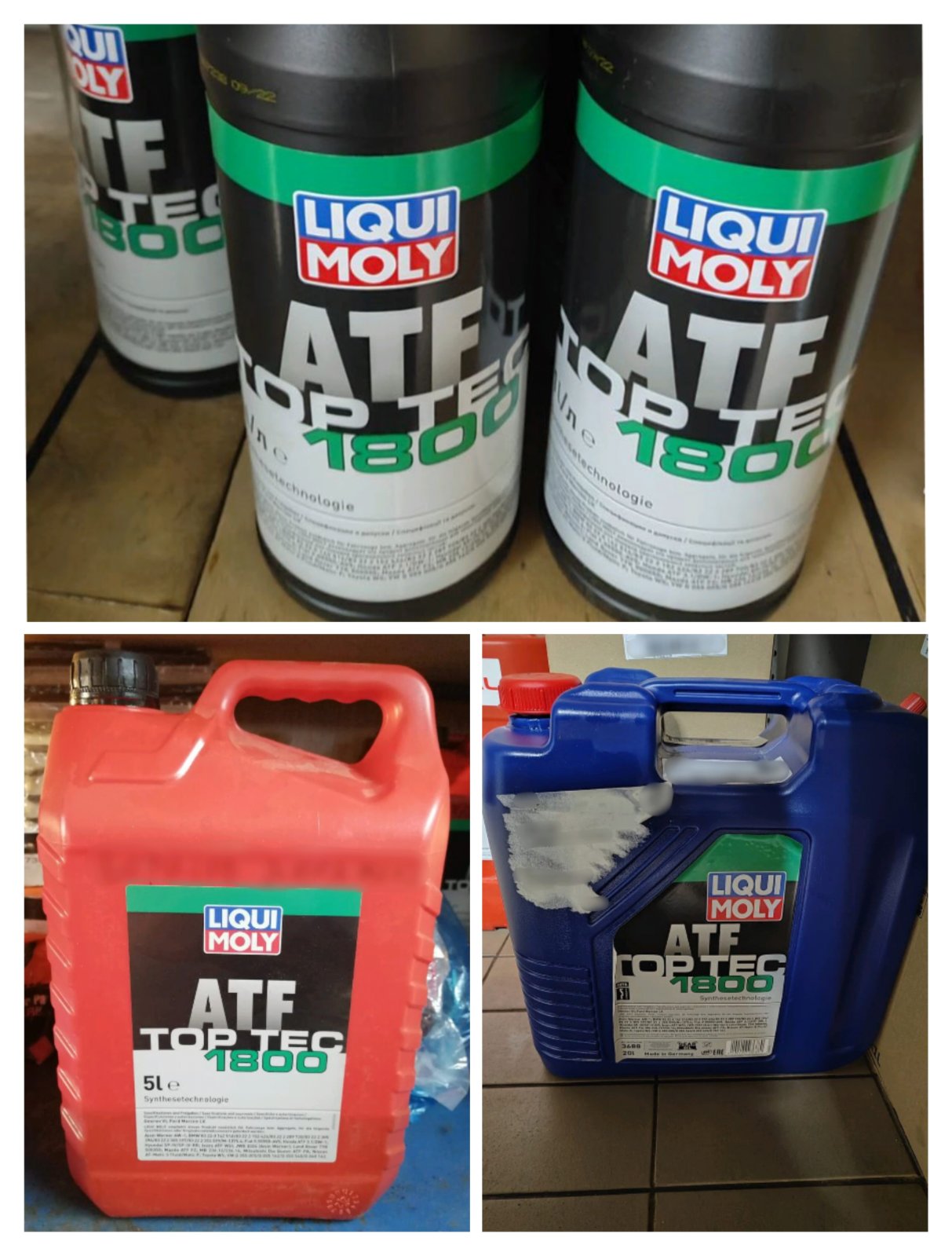

Liqui Moly ATF Top Tec 1800
20662
6950 (Emex)-5л.
7700 (Ozon)-5л
