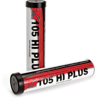

почти шрб, барий плюс минералка 200 сст
SWEPCO 105 HIGH IMPACT PLUS GREASE
Typical PropertiesNLGI Grade ............................................. #1 .................. #2
Penetration, @77 F, ASTM D-217 .......... 325 ............... 280
Color .......................................................................... Amber
Thickener Type ......................................... Barium Complex
Density, Lb/Gal (kg/l) @ 60OF. (15.5OC.) ........... 7.73 (0.93)
Texture ...................................................................... Fibrous
Dropping Point oF (oC), ASTM D-2265 ............... 375 (191)
Base Oil Viscosity, cst @40C ................ 218.0 ......... 216.8
Base Oil Viscosity, cst @100C ................ 17.0 ........... 16.9
Timken OK Load, Lbs., ASTM D-2509 .......................... 30
Oxidation Stability, PSI Drop, 100 Hrs, ASTM D-942 ..... 4
Rust Prevention Rating, ASTM D-1743 ............................ 1
Shell 4 Ball Weld, Kg. ASTM D-2596 ............................ 315
Shell 4 Ball Wear, Scar, mm, ASTM D-2266 ................ 0.50
Leakage Tendencies, ASTM D-1263 ......................... Pass
Copper Strip Corrosion, ASTM D-130 ........................... 1b
Lincoln Ventmeter, psi@ 0F ............. 1150 .................... n/a
Lincoln Ventmeter, psi@ 30F ............ 575 ..................... 975
Lincoln Ventmeter, psi@ 74F ............ 250 ..................... 475
Optimum Operating Temperature Range F (C) ......................................... -4 to +350 (-20 to +177)
Southwestern Petroleum Corporation
Fort Worth, Texas Phone: (800)359-5823 or (817)332-2336 Fax: (817)348-7237
Web: www.swepcolube.com

Музыкальная, только пока не купить, санкции не спешно снимаются, к Новому Году возможно уже заказать от туда :yes:
Swepco 105 high impact grease demo
