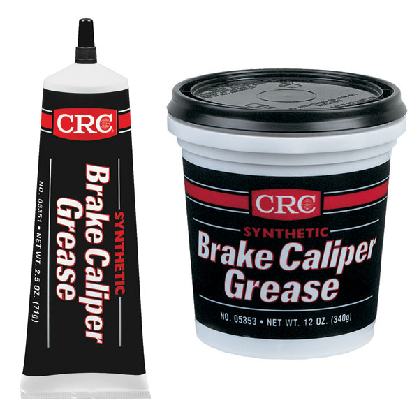

CRC Brake Caliper Grease
http://www.crcindust...er%20Grease.pdf
