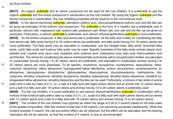

Вот еще выписка из патента от Kyodo Yush на их смазку, все таки насколько подробно они все описывают (последние строчки самые интересные):
[0041] The content of the rust inhibitor may typically be within the range of 0.05 to 5 mass% based on the total mass of the grease composition. With the content of less than 0.05 mass%, rust cannot be prevented satisfactorily. When the content exceeds 5 mass%, the rust prevention effect can be obtained, but the effect will be saturated, and the bearing lubrication life will be reduced, so that the content of 5 mass% or less is recommended
Изменено пользователем yorker
Повторюсь ссылкой на использование алкарил сульфоната как моющей и антикоррозионной присадки в моторное масло. Есть, кстати, промывки двигателя на его основе.
Lubrizol alkaryl sulfonates (are critical engine oil additives that clean the engine and provide antirust protection) Their detergent action helps neutralize acids produced during fuel combustion that can damage engine parts). The detergent also helps keep small particles suspended so that they can be removed by the oil filter and not build up in the engine.
