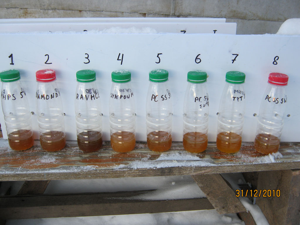

-25 Моторные масла вязкости 5W-30 5W-20
Новые образцы
Teboil Diamond 5W-30
Petro-canada Supreme Synthetic 5W-30
Petro-canada Supreme Synthetic 5W-20
Номера масел:
1) Ravenol HPS 5W-30
2) Teboil Diamond 5W-30
3) Ravenol HCL 5W-30
4) Valvoline Synpower MXL 5W-30
5) Petro-canada Supreme Synthetic 5W-30
6) Petro-canada Supreme 5W-30
7) Toyota 5W-30 SM
8) Petro-canada Supreme Synthetic 5W-20
Победители:
1) Petro-canada Supreme Synthetic 5W-20
2) Petro-canada Supreme Synthetic 5W-30 и Petro-canada Supreme 5W-30
3) Toyota 5W-30 SM
4) Ravenol HCL 5W-30
5) Ravenol HPS 5W-30 и Valvoline Synpower MXL 5W-30
6) Teboil Diamond 5W-30

Помутнение масел.
Масла 5W-20 и 5W-30
