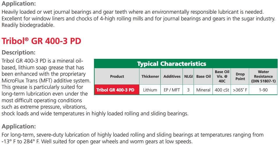

Tribol GR 400-3 PD previously called Olista Longtime 3 EP.(c)
400 cSt из доков Castrol.
SACHS.pdf Tribol_GR.pdf
Изменено пользователем verlube
