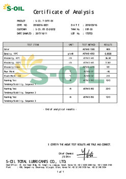

S-Oil Seven CVTF свежее за анализ спасибо Денису Михалеву.
S-Oil7 CVTF.pdf            S-OIL+7_TDS (1).pdf
Масло заявлено как:  Honda HMMF/HCF-2, Toyota TC/FE, Nissan NS-1/NS-2/NS-3, Daihatsu Amix CVTF-DC/Amix CVTF DFE, Ford CVT23/CVT30/Mercon C/Wss-M2C933, Suzuki CVTF 3320/TC/NS-2/CVTF Green1/CVTF Green2, Mitsubishi Diaqueen J1/Diaqueen J4/SP-III, Mazda CVTF 3320, Mini Cooper EZL 799/ZF CVT V1, Subaru iCVTF/Lineartornic CVTF/K0425Y0710/CV-30, Audi/VW TL 52180/G052 80/G052 516, Punch EZL 799, Hyundai SP-CVT1, Hyundai Kia SP-III, Dodge/Jeep NS-2/CVTF+4, GM/Saturn DEX-CVT, Mercedes Benz 236.20
