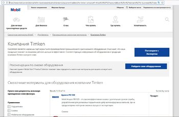

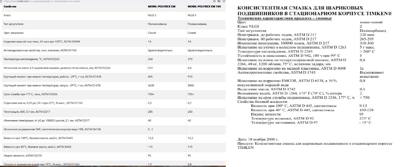

MOBIL Polyrex EM=TIMKEN GR220C- полное совпадение техдоков.
746183276_..thumb.jpg.5f24aa74f29158b4e7a0328d8a9f0c56.jpg985078591_SKFLGHP2.thumb.jpg.be7941bfffc25ffc0c898ec7f60cf978.jpg
SKF LGHP- максимально близка смазкам выше по ТТХ.
 Мобил- партнер Тимкен.
https://www.mobil.com/en/lubricants/for-businesses/industrial/lubricants/equipment-builders/the-timken-company#t=https%3A%2F%2Fwww.mobil.com%2Fen%2Flubricants%2Ffor-businesses%2Findustrial%2Flubricants%2Fequipment-builders%2Fthe-timken-company&sort=%40doctitle ascending
