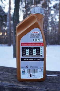

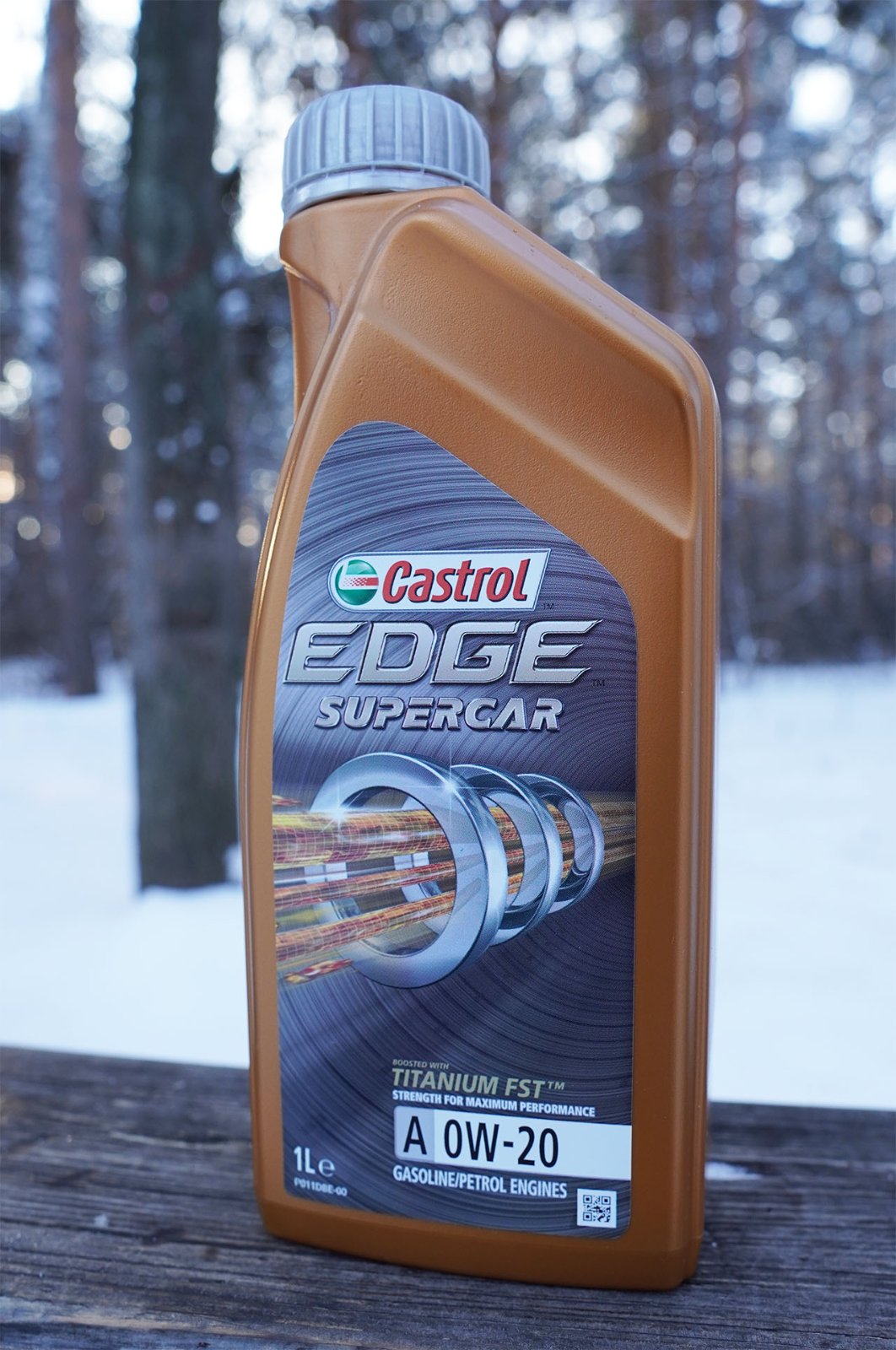

Castrol EDGE Supercar A 0W-20 свежее Shear Stability
