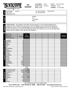

колличество магния и параметр ТАN поражают
Should be Esters based oil, so high TAN, like Redline MTL for example (http://i95.photobucket.com/albums/l142/unleashedbeast/Oil%20Analysis%20and%20Amsoil%20Pics/21e55542.jpg). I like the pack ZDDP + Bromon also. But very expensive oil only sold by Volvo... About 20€/l

Zinc, phosphorus, magnesium, 10.53 Viscosity at 100, this oil can be poured into the engine. :D

Btw, I have an UOA of a volvo 244 gearbox from 1978 I just bought but with only 60 000km filled with factory ATF. The wear results are awfull... (Attached).

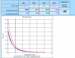

I have so done this VOA to find a better replacement. After looking to several oils, it seems the best are BMW MTF LT-2 oils which have a similar viscosity profile (attached)
I am testing now the Ravenol MTF-2 in my M47 since 1000 km and the shifting is very good for now. I am waiting for winter to see how it will perform.

The viscosity at 100° is a little low compared to ATF F specs:
Type F
viscosity at 100° > 7 cst and > 6.2 after 8000 cycles of WOT test
But should not be armfull in a manual gearbox. Low temp viscosity is quite similar to the ATF.
BUT, as there are sold as "low friction oil", I don't know how they will work in M41 or M46 gearbox with overdrive with its clutch, filled also with ATF F...
